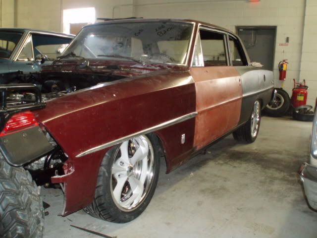

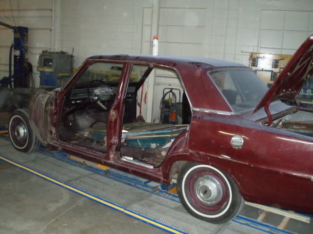

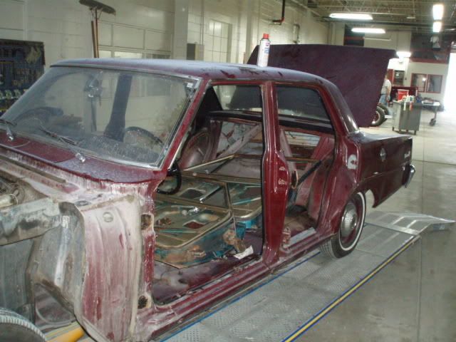

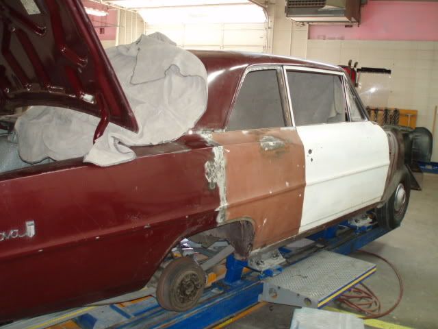

Here are some old pics I rounded up of the transformation of a 4 door into the twin turbo 2 door sedan.:yes::yes:

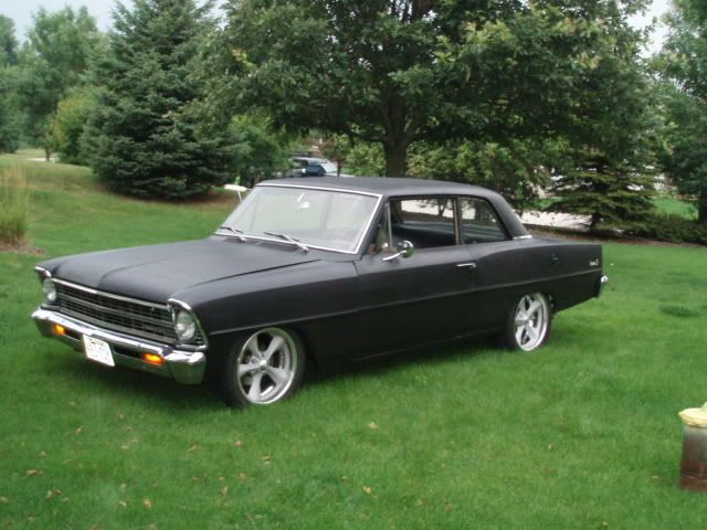

A case of krylon and the rest is history!!!!!:D:D

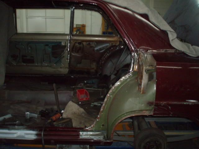

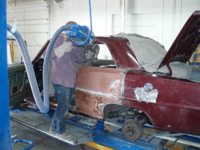

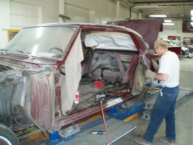

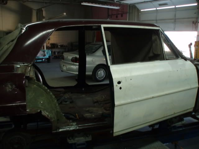

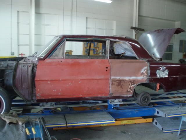

We hung the door to determine placement for quarter. The b pillar is spot welded so we drilled it and replaced it with the sedan section. Quarter was but welded. These are the only pics I have as my other computer crashed and found these on my photo bucket account.

Thanks this is why the car is my favorite by far. It was the cleanest 4 dr I had ever seen. The only reason I cut it up as it was hit in the drivers side doors and light quarter damage on the same side. Got to love cars from Cali

Looks good. I've been debating on doing the same to a rusty 57 Bel Air I have. Now I have "some" confidence that it can be done. I was worried about it looking like a frankenstein, but your car looks great. Ok, time to get out the sawzall!
