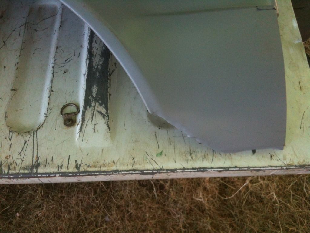

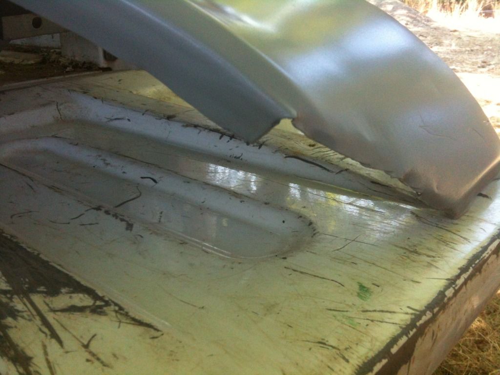

I searched and could not find this. I would have thought somebody else had the same problem. I would like to repair my front fenders on my '63. Or should I just find some used fenders?
Can somebody please post some pics of what it is supposed to look like and maybe some dimensions? Or does somebody have some fenders that they would cut me this section off of? Both fenders are cut similarly.:(

The patch panel needs to be installed with the fender on the car. You will not need any measurements, align the patch to fit the door, rocker etc before
welding.

The area pictured is the front of the fender and it was trimmed (badly) for tire clearance
What Ryan said. Both sides look like poo.:(
fender should still be on when repairing. It is very easy to get the repair crooked off the car. Align the fender to rocker and door, then you can visually see misalignment in the patch. Sometimes I will use a straight edge to visual look at the curvature. it does not have to be straight to use a straight edge. I would also take measurements from the lip of the patch in to a point on the body or frame.
