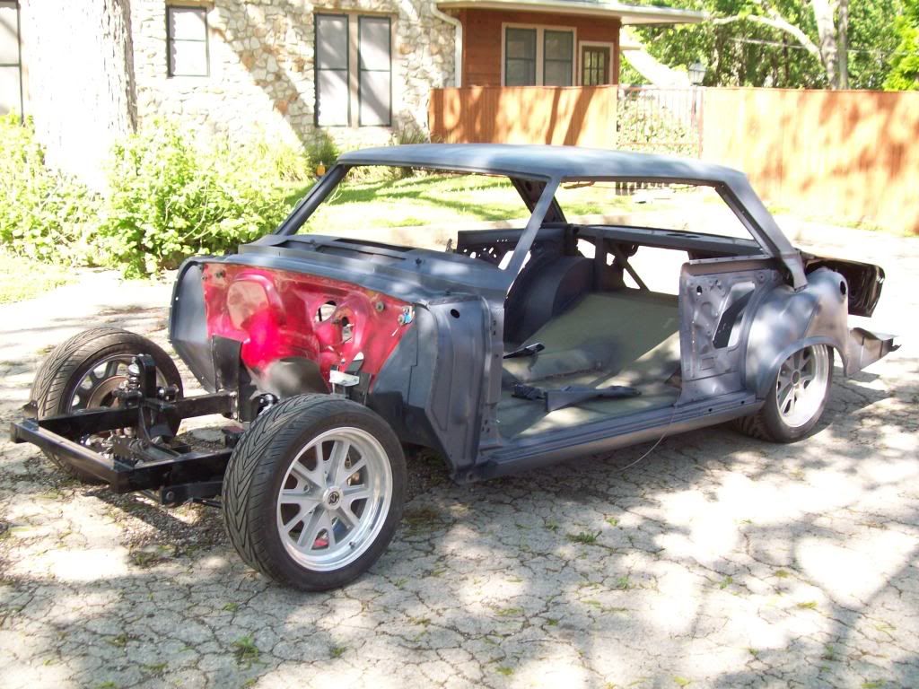

The sheetmetal and bodywork are finaly finished. Just got primed for the first time and blocked out. One more heavy coat of primer, and second blocking, fix a couple of issues, and take it all apart one more time for painting. Going to go on the roto to paint the frame rails with porcelen chassis black, mask that off and truck liner on the floor sheetmetal to deaden the noise, water proof the car and seal up all the cracks. I am going to paint all the sheetmetal seperate and put it back together for the last time. Now the real fun begins, assembly, interior, wiring, brake lines, and lastly get the money to purchase the engine. Going with a Turn Key Engine Supply LS3 with a hot cam for about 500 hp and 20 plus miles per gallon.

One step closer
IN THE BOOTH FOR SECOND APPLICATION OF PRIMER
SECOND PRIMING COMPLETE

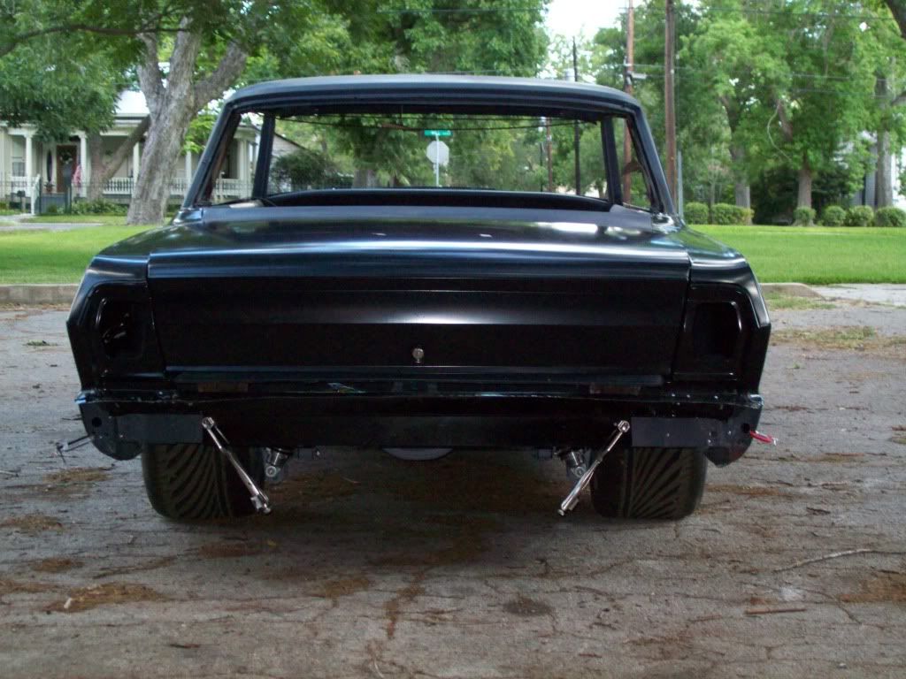

DIDN'T SOMEONE WANT TO SEE THE ARCE END, THERE SHE IS

I have not got the underside done yet. In fact, I found several issues to resolve with the body that will need attention. The aftermarket lt door skin I installed does not fit very well and I had to unfold the edge at the top of the skin and refold it to lengthen the skin to correct a gap problem. I have a few other minor issues and I plan on finishing the bodywork this weekend and guide coat and block the primer next week. Then it will be ready for the underside I will update with photos as I go.
