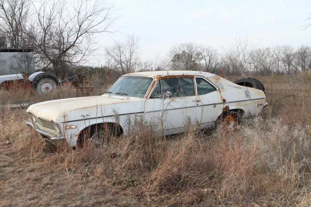

This is my girlfriends car from highschool. It has been sitting in the pasture for 10 years with a broken rear window. I am going to help her get it back running and in good daily driver shape. It wont be a frame off resto, but I dont want to do a shaby job either. She is keeping the white color but wants to clone an SS car. What all trim do I need to be looking for? I believe I need to paint the grill and surrounding parts black and add the SS emblems and the same on the rear tailight filler panels. I am definately open to some suggestions and help on making her car come back to life. It really makes her happy just thinking she may get to drive the car again someday.

I think the first thing I would do is drop the gas tank and have it cleaned before you attempt to start it. No need to add any trash to the fuel system. Good luck with your project,,,, Ron

That was my plan until I found out it has a full tank of gas and her parents do not want me spilling any fuel. I was planning on gravity feeding the fuel to some gas tanks and then disposing of it. I wll be rebuilding all of the fuel system so I changed plans to add octane and just get it the two blocks to her house then drain the old fuel.

You may just want to put it on a flat bed and have it delivered. After sitting that long, the brakes may not want to work all that well. The wheel cylinders may need to be freed up.
You have a good looking project there, I've already torn it down repaired and replaced and have the body painted......in my mind. Have fun and keep the pictures coming.

No offense. I can say "yuck" because your car looks to be in about the same awful shape as mine when I started on it. You can have a look at my build thread (link in my signature) for some ideas of what you may be facing. Lots of projects start out with the belief that there won't be all that much to do, then you dig in and find so much wrong that the constant money stream starts. Not wishing anything bad on you, but don't say you weren't warned.
In any case, I wish you the best of luck with your project. I would so much rather see a car put back on the road than sold for parts or sent to the crusher. So, thanks in advance for doing just that.
