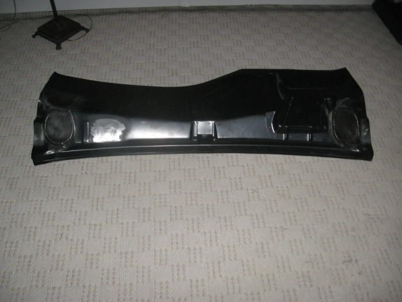

Your answere is yes. I replaced mine with a 1969 camaro one. The only thing you will have to do is plug two holes on the inside cowl. Camaro had astro vents that the holes were used for.I welded mine up. other than that they are the same. Hope this helps.
Steves70SS
Thanks fellow, nice pictures. John

Hey John, Mine was a one piece unit. It did take some time getting the old one out. Yes you will have to take out the windshield, Dash pad, and do some welding but when your done it will be all brand new.I had the holes tig welded by a pro and came out very nice.not cheap but nice.If you need any pics let me know.
Steve
