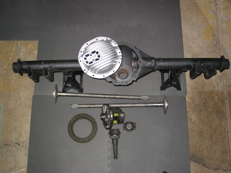

So far, so good. We'll see if it leaks or anything in service. :yes:How do you like the aluminum rear cover? I see them on ebay and was wondering how nice they were![]()
