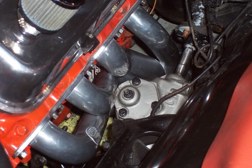

i am putting a zz 502 in my award winning 43,000 mile 1969 L-78 nova. and hell yes i am having issues, i am wondering if any one out there has also been down this road. my biggest problem has been with header fitment.i also can help if anyone is doing this since i am almost done with my project.
i have installed a 9 in. moser w/ cal tracks and am running a 400 turbo and am trying to keep my car pristine and easily return to stock.no welding/drilling or cutting.but this header issue has pissed me off!i have tried the hooker super comps 2.125-3.5 combo. i am now looking at the hedman 2.0-3.0 header do i really need 2.125 pipe and 3.5 collecter? my 502 will make about 550 h.p (it is not stock crate) does any one have these hedmans on a zz502? i will sit back and chime in if any one has any thoughts on this thanks. rat

Sanderson Headers in So. San Francisco, fabricate custom headers. They've made just about every kind of header to fit everything. A bit more expensive than mass produced, but worth the money, especially for an award winner.

Well first off I think unless you have someone custom make headers you will have some clearance issues. Especially if you have power steering. Every nova owner I have met with a BBC has had to beat a tube in a little for clearance.
If you don't want to ding your headers up any, I suggest having a custom set built.

Spend the cash and get some one off customs, your heads if aluminum have raised exhaust ports. ans for 550 hp really a 1.875 tube will be fine. and your not going to rag on the car. so really header size is moot. hell just put the manifolds back on.....

I had custom headers made for my '64 to use with a big block and a 4-speed. If you get custom headers made, the shop will need the car with the engine to do it.
My headers cost $750 in mild steel and would have been $1,000 in stainless. I chose the mild steel though because I wanted to ceramic-coat them. They have 2-1/8" primaries with 4" collectors and are definitely "one of a kind".

the headman 2 inch primaries will not fit without grinding the flange to clear the headbolts ...

My 69 BB has 1 7/8 primaries into 3" collector with manual steer and everything clears,but I have no idea who makes them,they were a freebe!

Hooker 2" Comps! 1/8" between the tube and the box.

Doesn't the heat raise cain with your steering box?

At 550 hp you'd be in the 1.75" range for the primary tubes, 40+ inches long with a 3" collector. The smaller primaries will enhance the torque in the rpm range you spend the most time in. Hedman makes something you might start with.
