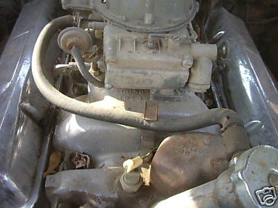

I have pictures of an original L79 with the PCV hose & bracket in front of the carb but also have many restored pictures showing a diferent hose routing and need to know what is correct? I was told the first picture is an unrestored original untouched L79:
Picture of untouched original L79:
Many restored L79 look like this, apears to be incorrect:
66 Nova SS L79, under restoration.

L79 Hose Bracket
Here is a picture of that original hose bracket in place on my L79:

That PCV hose bracket is very rare and seldom seen on L79s, even those restored by L79 gurus. In my picture album of dozens of L79s, only one other shows that bracket. The 1966 assembly manual shows it, so clean it up, put it on and then get ready to substantiate it's correctness to all the L79 'experts.'

I have noticed the front bracket shown in the 66 Assembly Manual. It does not give a part number and is not drawn as dark as the listed parts. It would facilatate turning the oil tube assembly clockwise to 32 degrees of center. If you did not have the additional (center) bracket, the hose would probably hit on the carb. I have an original Assembly Manual and it shows it the same as the reprints. If I had the bracket I would definately use it. Guess I need to locate one.

I have seen this one before, as well as the corvette type that mounts to the carb stud. Could this be routing/bracket for a car with A.I.R.?. I have pictures of the engine of a Canadian built car brand new and the hose has a bracket that comes off of the top valve cover bracket. The Canadain cars also have a different alternator bracket, that mounted off of the water pump and front intake bolt.

Almost looks like the bracket whether mounted to the thermostat housing or carb stud is the same. Could be a variation based on the period the car was built or assembly line preference.

The Hose bracket is almost the same but a little longer with a bend at the thermostat housing. The referance to the pulley, is it the alternator pulley because mine is the same from a resturation shop that explained that was the pulley I needed for the L79..........

The 37 amp alternator had the large deep groove pulley, as I have had origional cars that confirm this. I also have pictures of an engine compartment of a Canadian car the first day it was delivered, showing the PCV hose bracket comming off the valve cover bolt, and the three point alternator bracket, and how meesy the fire wall wires and hoses were as assembled. Frank

I noticed in the 66 Nova Assembly Manual (page 233) that the front bracket (ventilation) for RPO L30 & L77 seems to be the same bracket that is listed on page 258 under RPO L79. Part #3877445.
