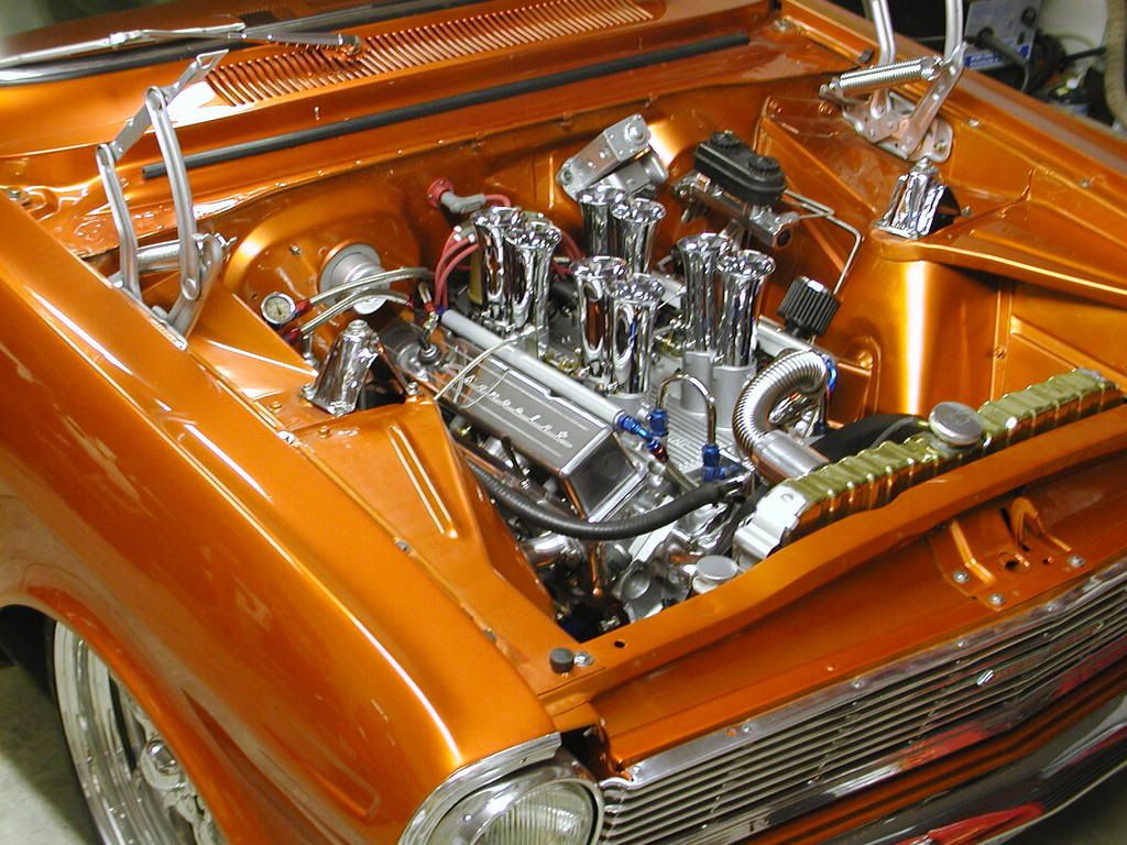

I made mine 12 years ago but there is a place that is making them. I've seen them on ebay and there was a post about them here on steves somewhere.It certainly does force more air to get through the radiator. I did mine more to clean up the area between the grille and rad support. A couple o screws per side removed them to let me clean out the bugs. [IMG][/IMG]
