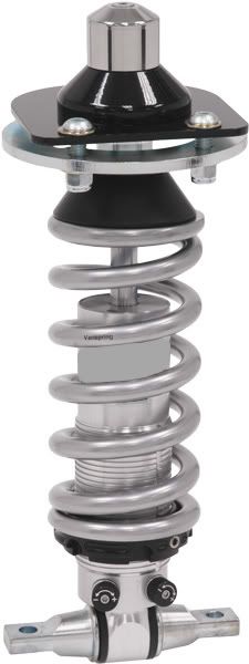

Now available is our CBR/VARISHOCK coil over conversion for the 62-67 ChevyII Nova. Converting the stock front suspension of your 1962 to 1967 ChevyII Nova to coil-over shocks is now a simple bolt-on procedure (Some applications will require a small amount of grinding). Our exclusive modular shock-tower-adapter system and spherical-stem assembly gives you the ability to use our system in a variety of performance applications. The tower adapter and lower crossbar replace the factory shock mount and lower spring perch respectively. Lightweight billet-aluminum VariShock coil-overs are available in 16-position single-adjustable or 256-combination double-adjustable versions. Kits include shocks, springs, tower adapters with reinforcement plate, and mounting hardware.
VAS-86X10F1 788.00
62-67 NOVA CHEVY II BOLT-IN FRONT SINGLE ADJUSTABLE COILOVER CONVERSION,
INCLUDES SHOCKS, SPRINGS & SHOCK TOWER ADAPTERS.
MAS-86X10F2 988.00
62-67 NOVA CHEVY II BOLT-IN FRONT DOUBLE ADJUSTABLE COILOVER CONVERSION,
....and shown with optional polished cap/double adjustable

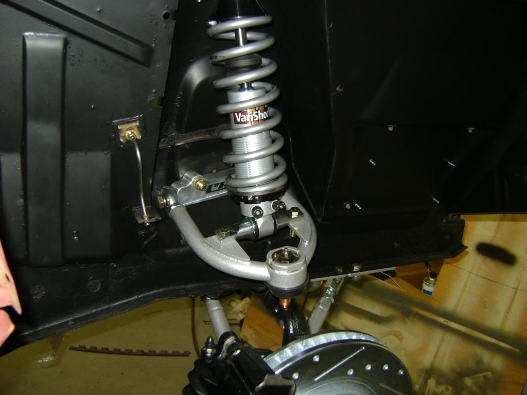

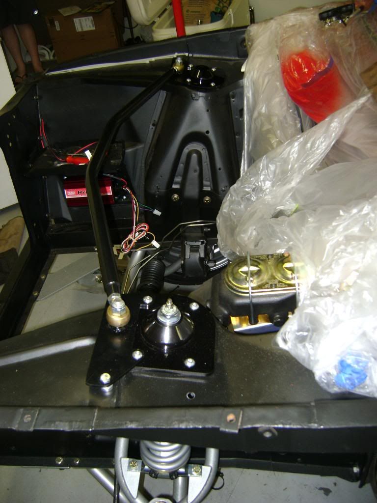

Finally got a chance to work on the car today, put the new uppers and coil overs on, sure was a quick and easy install now I have a complete CBR front end!.. Thanks Chuck!!...
Now to make some cool caps to cover the stems!..

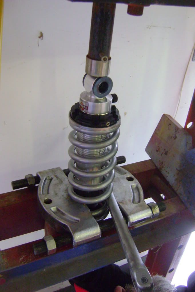

I have gotten a lot of questions on how to get the springs on,here is how we did VooDooII's this morning.
That's pretty much how I did mine and Derek's, only I used some blocks of cherry I had floating aruond in place of the bearing plate. It made it easier for me to match the spring angles and keep the assembly straight in the press.

Hmmm, never thought about doing it that way, I just compressed the springs and used hose clamps with thin rubber to hold them worked out pretty good!..

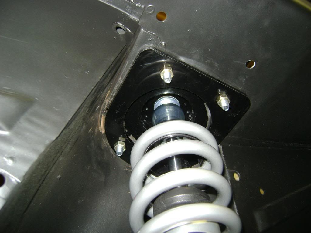

Just curious,does the lower coil over mount(to the uca) have any kind of bearing element in it? Since its eliminating the rocker perch (good) does it have needle bearings or a swivel ball or just polyurethane?

It is a polyurathane type bushing,not sure exacly what the material is
