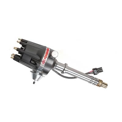

Just ordered this from the local speed shop. Professional Products plug and play small diameter complete distributor- $175 + tax. Spent more $ than the points conversion but i'm excited.
Looking forward to adjusting timing at the twist of a knob.

I've been curious about the Powerfire distributors. Let me know what you think of it once it's installed. Professional Products bought them from a smaller company.
