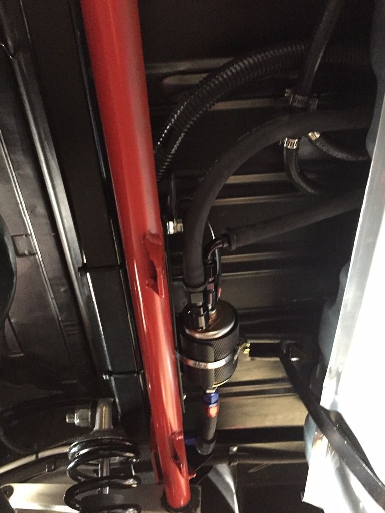

Ok, I got some candy for the car.
I won't weld this pan in until I finish the rails. But it is also nice to have the tank and headers ready and waiting.
I need to research on the fuel line set up since my engine intake is returnless and this pump has a return line.
I really want to get my car back on the ground and rolling.

A lot or most people are using a Wix filter for a Corvette. It's regulated to 58 psi and has a return so you can mount it right by the tank. I've been using one for 20,000 miles with out any issues. Only use a Wix or AC delco, people have had problems with other brands. An example below from Summit, not sure what brand filter it is ?
https://www.summitracing.com/parts/c...MobileSwitchNo
Thank you for the info. I wasn't too sure if WIX was ok, but knowing your experience I feel much more confident using WIX.
I still need to study up on the layout of the fuel line and which PTFE line to buy. I saw some cool looking black with blue braided line, but it wasn't PTFE. I am basically just finding all steel braided kits. This tank I have is from Rick's so I am sure I can call Hector for more advice.

I ran as much hard line as I could then a short piece of push lock at the rear and a piece of braided at the front.
