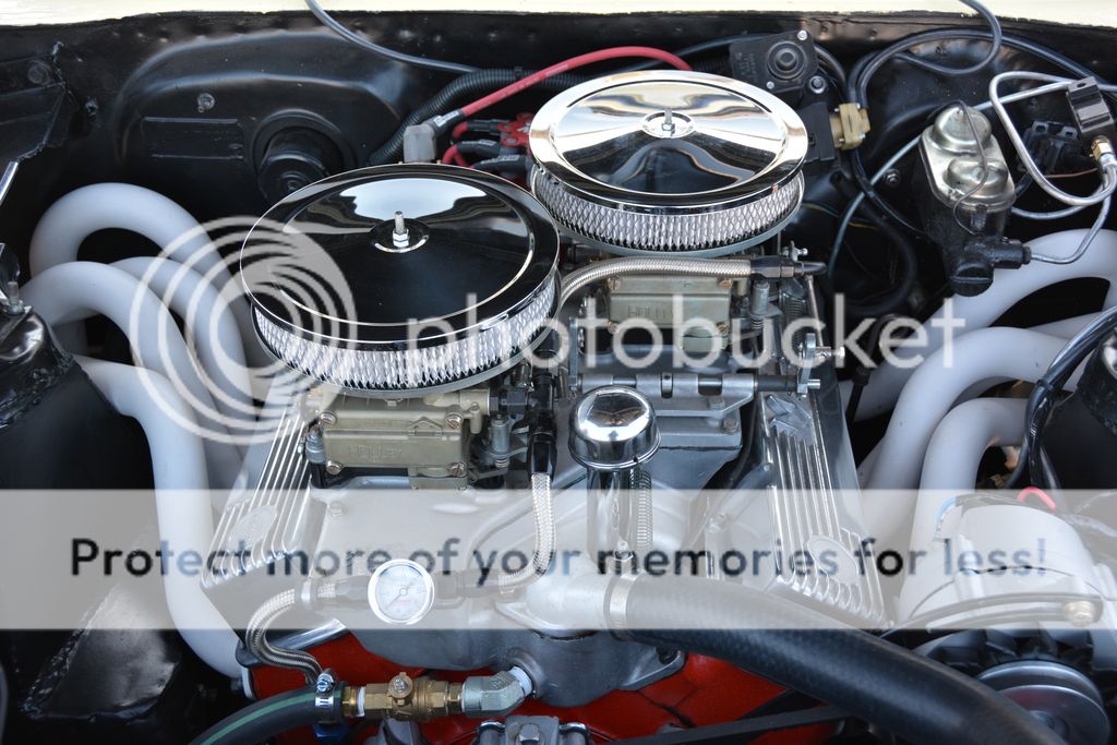

No, these are the actual ones
Click image for larger version
It would be easier and have a cleaner look to use breathers but the reason I would like to keep my pcv is that I've been told it's not that good for your engine not to have it.
I kinda like the Chevrolet logo on the valve covers tho,not sure if I wan't to drill through them.
Yes, I will use baffles to prevent oil sucking out,thanks!

Originally Posted by Roddychop View Post
Definitely keep the pcv. One option is to put the valve cover with the pcv hole on the passenger side. Put the other valve cover on the drivers side with a breather in the oil fill hole that way you will get cross ventilation through the valve covers. The tricky part will be to get a breather grommet with baffle to seal around the hole with the notches. I think in the past I used silicone to seal up any gap.
Originally my passenger valve cover hose is going to the air cleaner. The driver side hose is going to my Holley carb. I've noticed that only one of the M/T valve covers have chevrolet logo, the one with the oil fill hole doesn't have the logo. I think I'm going to drill into that one to connect the carb hose to. First have to be sure about the measurements of the grommet but it's possible to keep everything the same that way. Meanwhile I've purchased the covers so we shall see
Thanks for thinking with me!
By looking at the pic of the valve covers what would you people do, polish them or put them on like they are?
Yes no reason not to keep it the way it is, I wasn't sure if you had an air cleaner connecting to the valve cover.
If it were mine , I would leave them unpainted, clean them up good with brake clean and hand polish the sides and top of the fins with something like mothers aluminum wheel polish.
