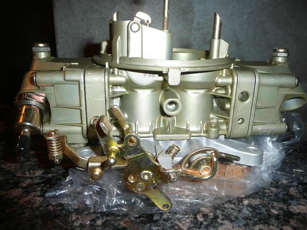

Guys, just had my carb done buy Tom Zeman ghostt performance in NY what a job this is for a Mustang but he does GM stuff also this guys has a a great rep for restoring carbs.

Outstanding Job. Is that his contact info at the top?

Looks great. Go for it Buddy. My friend might have mentioned him also. My friend is probably on that Corvette forum as he finds hard to find stuff or it is in his inventory. He also owns a 57 vette. My carb is rare enough and he had three of them in his possession he had probably got 25 years ago. He just found a carb for a Shelby Cobra and had a guy restore it so it looked as it came on the car in 66 and was clean but not restored looking. A guy did it just right for him and the client was pleased. My friend is super knowledgeable about carbs. He looked at one I had and pointed out three things wrong that were not obvious to the normal person but looked correct.
