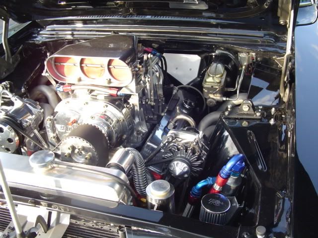

I have the churchboys rack setup on mine and just love it. Drives like a new car.
http://www.stevesnovasite.com/forums...ad.php?t=86968
Chuck and his Dad are great will answer anything you may want to know. I really like the looks of the rack behind the cross-member and not in front were it can be hit with something going down the road. My car set low so I have to keep up with stuff in the road. And you can get the rack at any parts store and they are cheep compared to some of the other racks out there. No welding bolts right in. And you can it a peace at a time and add on as you get the time and money.

Yes and if and to do away with them you will have to do a lot more that just putting a rack under it. As you can see I am still running them. And I have the car handling great with the rack and lager sway-bar.

Ya I looked over your car at the Nashville goodguys show really good. Very nice I'm planning on the whole front clip coil overs alum fender panels not just doing a rack and pinion steering swap. By the way what kind of tub job did you do to tuck them big ol' tires

It was all hand made long before all these nice kit came out. Even the 4-link was home made " well it was made out at TVA in the Boiler shop". A big Power Plant has a lot of nice tools.
