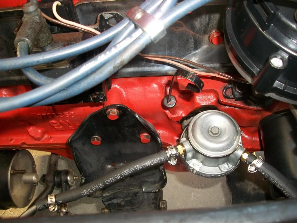

So I finally got some pictures!
The first shows my 194 in my Acadian which should be the same as my buddy's.
Am I correct that the flat spot to the left of the GM, just above the starter is the boss for the rear sump dipstick?

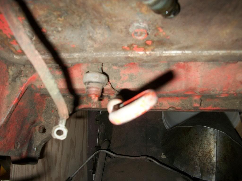

the following pics are my 250 on a stand with the side we need to see up against a wall this showing rear sump dipstick
Is the round button between the fuel pump & motormount the front sump boss?

In the top pic that pad is for center sump, rear sump is second pic, in the bottom pic it could be for a front sump?, my 250 don't have that pad but mine came out of a 3rd Gen, but every front sump I've seen were like the top pic sooo???...
