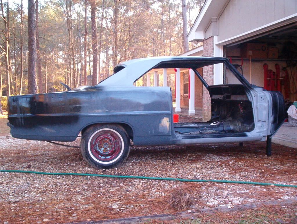

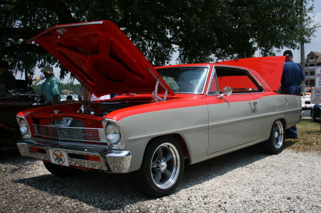

Started With
Finished With
It's only money!
http://i911.photobucket.com/albums/a...wWheels010.jpg
