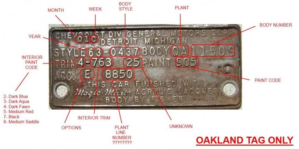

Here is a quick decoder i made for Oakland cars after the Nova Mini Nats last year. I still have to make one for the other factories, because the interior paint code is located in different spots on each tag.
Good information. Having this info for the other factories would be great.

what about 763? no arrow/description. it looks very helpful, thanks!
763 arrow indicates that marking to be the interior trim.

is there any guesses on what the 25 (unknown) is for?
I need to take a look at my oakland 63 ss and see what the number is
A guess may be the convertible top color - but it's just a guess. I don't know for certain.

Except an 0437 car is a coupe.

^ That's a good point. Any ideas ???

Ok here is the working theory I have on that unknown code. So far it doesnt go over 31 and it seems to corespond roughly with the week, averaging about a few days after the coresponding week.
This is straight out of my spreadsheet.
Oakland cars
Week Unkown 1
A 12
A 06
A 08
A 03
A 04
A 09
A 06
A 12
A 05
A 07
A 11
A 12
A 07
A 08
A 08
A 08
A 03
A 12
A 05
B 12
B 07
B 12
B 17
B 13
B 13
B 20
B 13
C 25
C 25
C 21
C 15
C 25
C 15
C 15
C 28
C 13
C 22
C 01
C? 23
C? 23
D 24
D 22
D 23
D 30
D 23
E 29
E 05
Norwood cars
Week Paint
A 912-15
B 900-11
B 919-11
B 973-14
C 973-19
C 973-14
D 914-22
D 912-26
D 936-21
d 936 27
D 948-26
D 912-26
D 900-25
E 918-2
Kansas City cars
Week Paint
A 912A 11D
A 912A 6C
A 918A 7C
B 948A 11C
B 936A 16C
B 936A 16C
B 936A 12
C 936E 23C
C 936A 22C
C 936A 23C
C 938A 21C
C 936A 15C
C 922A 23C
D 922A 24(c?)
D 963A 25C
D 936E 25C
D 774 5
E 936E 27C
E 936A 3C
The Willow run cars dont seem to have any unknown info on them.
Sometimes there are acceptions, but not very often. I think it may be the projected date they wanted it off the assebly line.
