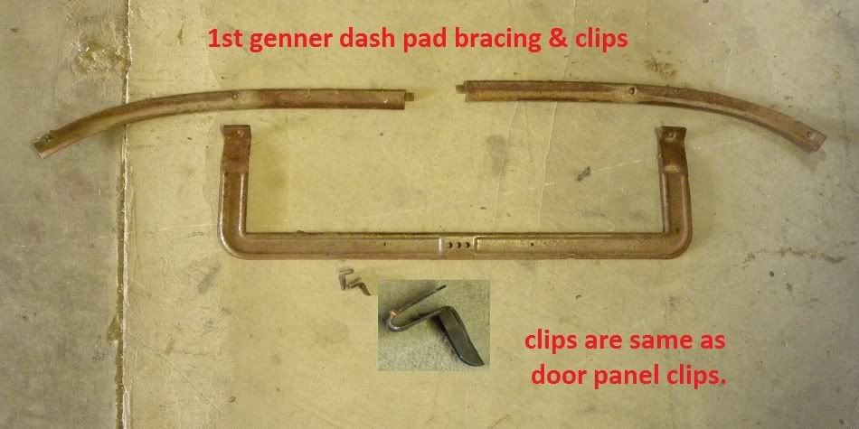

if i'm not mistaken ALL the 1st gen dash pads had an inner structure that assists in attaching it to the dash... the reproduction units do not have these pieces...
here's a picture of the structural pieces that are molded inside the pad... i removed them from an old unit for the visual assistance for others...
Johnny is right , they don't have these pieces but do fit like the original pads
kemmoschwabie
Kemmoschwabie is almost right Although he usually right about most things on these cars....they fit kinda like the original pads. At least thats how mine is. If you have an old original one that is suitable to be recovered, you will be much happier with it. If I would have known this, i would have had my original recovered. I still will have it done in the future.
I compared them side by side , on the cars and it looked pretty darn close to me but the again NOTHIN" fits like oem , I do see where the chrome trim fits it may not be a very good fit
they are also MUCH heavier
good thing I have two originals
kemmoschwabie
kemmoschwabie
Maybe you saw a better brand/mfg. Maybe there is hope after all. Remind me at the next gig and I will show you how mine fits. Definitelt cant use the chrome strip that went underneath the lip of the dash, cuz it dosen't quite reach the dash. Mine is kinda "free floating". You will see what I mean when you see it bro.
yea I'm pickin' up what your puttin' down
it does kinda "float "
I was able to peel back the vinyl from under the lip on the front edge and it is long enough to be covered by the chrome strip ( oem ones don't fit all that well under the chrome trim either )
I'm gonna try to use the stock clips that hold it to the dash
kemoschwabie
