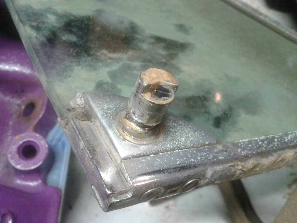

Old 20th-November-2012, 04:40 PM   #6
eazy
eazy's Avatar
Title: Nova Newbie
Join Date: Sep 2012
Location: Downey, CA
Nova(s): 71' Nova
Posts: 28
[IMG][/IMG]
Sent from my iPhone using AutoGuide.com Free App
Old 20th-November-2012, 06:01 PM   #7
jimys72
jimys72's Avatar
Join Date: Sep 2010
Location: Lebanon, MO.
Nova(s): 72 Nova, 78 Elcamino
Posts: 857
Yea looks like the post is broke off. do you have a replacement part? Probly easier to replace whole window. there are two rivets in the underside of frame. could drill them out and replace with short flathead ones. the whole thing is glued.
I have an extra frame if you need it. would Probly be easier. pm me.

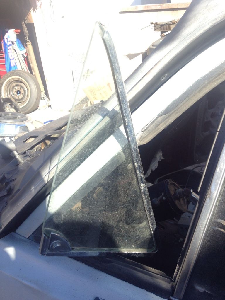

Old 20th-November-2012, 08:01 PM   #9
jimys72
jimys72's Avatar
Join Date: Sep 2010
Posts: 857
[IMG][/IMG]
