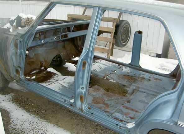

Alright! Been over a month since I touched the old girl.
I also run r/c boats as my other hobby, so winter time is usually build time for the boats. Ive got them nearly complete, so went out to the shop and started to tinker with the car a little bit more again.
I started to clean up the rocker panel I got from John. Started removing the remaining pieces from being but out. Another couple hours and it will be ready for welding up the holes I drilled from the spot welds, then onto removing the rest of the rocker and damaged B pillar from the car.
Then time to put the new donor parts in place! Anyways, onto some pictures:
Here is how it started out.

And here is where I left it when I came in for the night. Have a couple more pieces to remove, weld up the holes and she is ready to go in.

Alright, found some time today to work on the Chevy II. I got the old B pillar, and rocker out of the way. Plan is to at least have the rocker pannel, and b pillar tacked back in place by the end of today. We will see if I get that far or not. (dont have the inner rocker out in these pics yet, but the car is setting there currently with no inner rocker. Ready for the new rocker panel fitment )

rocker panel tacked in place. Will need to go get some steel to make a couple backer pieces for strength. I will also weld along all of the seams once I fit the B-Pillar here in a little while, and hang a couple doors to see how it all lines up before final welding.
