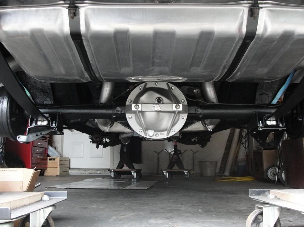

Update Feb. 9/13
Well the exhaust is finally done, we took our time to get it to where I'm happy with it.
Here's some pics of the setup; Hooker longtubes, Jegs 2.5'' mandrel bend kit, Dynomax Ultraflo's
Just need to finish putting the shocks on and ebrake, then back on its wheels

Rear end cover
Who makes that rear end cover? Looks really nice. I have chrome now but would like to change it to Aluminum as it will not rust over time.

Originally Posted by Zerex View Post
Update Feb. 9/13
Here is a twin to yours:
Beautiful car you have there.
Steves70SS
Those are more than a cover as they have the special bolts that support the third member bearing caps. I just put one on my car about a week ago.
I also bought new stainless allen head bolts as the one's that came with my cover were too short due to my 8.5 having recessed( about a 1/4")threads in the housing. At least the bolts will not rust on me and I did anti-seize them also.
