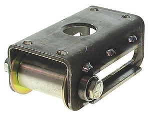

Originally Posted by david68 View Post
Here is a pic of the slider mounts that take the place of shackles.
Click the image to open in full size.
This is what is used on johnh' car and what Dan_Lebherz is refering to.
Thanks for the picture, those are new to me.
